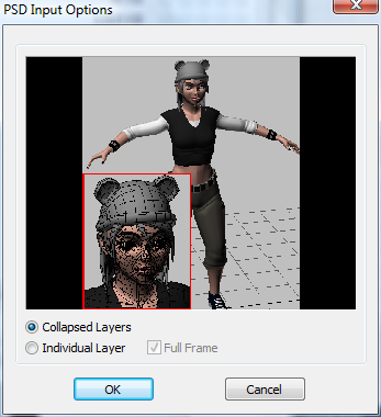

When you open a PSD file as a bitmap, a dialog appears that lets you choose how to use the image.
Collapsed Layers displays the entire image.
  • Collapsed Layers (The default.) Uses the entire composited image for displaying the bitmap. This composite must be generated when saving the PSD file (see the Photoshop help).
    Note: The composite image is used only for displaying the bitmap image; 3ds Max maintains all layers from the PSD file separately in memory. You can edit the individual layers and add new ones within 3ds Max with Viewport Canvas.

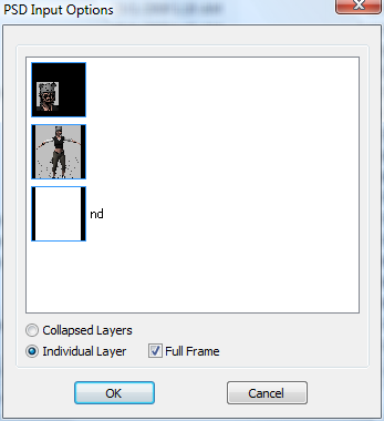

  • Individual Layer Uses a single layer of the image. When you choose this, the dialog shows a list of the layers, with a thumbnail of each, and the layer names. Click a layer to choose it, then click OK.
    Individual Layer displays list of layers to choose from.
    Full Frame When on, uses the entire layer as the bitmap. When off, uses only that portion of the layer occupied by image data. Default=on.
