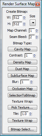

Interface
- W/H
- The width and height of the bitmap to generate.
Tip: When generating bitmaps for use in real-time-rendering applications, such as games, both dimensions should be powers of 2, such as 256 or 512.
Size - Choose a size from the list of presets.
- Map Channel
- The map channel to use when generating the bitmap.
- Seam Bleed
- Determines how many pixels are added at UVW borders as “padding.” These bled pixels will never overwrite the pixels within UVW seams.
This value has no effect in SelectionToBitmap.

- Contrast
- Determines how much extra contrast is added. In a very high resolution mesh the surface does not change much from polygon to polygon, so in such cases it might be neccessary to increase the contrast to get the difference in concavity/convexity to show clearly.

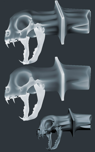

- SubSurface Map
- Generates a grayscale image that displays an estimation of the relative volume of a poly object at a given point. White represents the thinnest parts and black represents the thickest parts. You can then use this map to simulate greater translucency in thin areas.
The resulting map does not necessarily represent accurately how light would pass through the surface but can be useful for simulating this.
SubSurface maps created from a poly mesh, showing different Blur values
The upper two images use flat shading so that only the texture is visible.
- Blur
- The degree of blurring applied to the generated map.
In the preceding illustration, the top rendering has Blur set to 4, while the center one has Blur set to 40. The bottom rendering shows the poly object without a texture map.

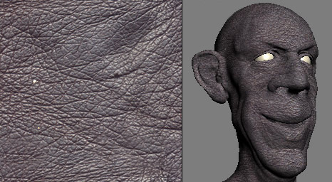

Texture Wrap
This tool creates a texture map from an input texture and wraps it around the selected object in a way that creates no texture seams and with a uniform texture scale across the surface. It projects the input texture from all directions and blends the result based on surface normal. A good use for this tool is to provide a base texture for a model. For example, you can create a basic skin texture and wrap that around the whole character model in a seamless way. Another use is for complex shapes such as a tree and all its branches.
To use Texture Wrap, first click Pick Texture to specify a texture file, then select the object to wrap and click Texture Wrap.
The input texture (left) and the resulting wrapped texture applied to a model (right)
- Pick Texture
Opens a file dialog for specifying an image file to wrap as the texture.
- Tile
The number of times the texture will be repeated across the object, both horizontally and vertically.
- Texture Wrap
With an editable poly object selected, click to wrap the texture.
