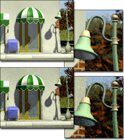

Before and after applying Film Grain to a scene

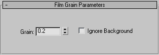

The Film Grain Parameters rollout contains the following controls.
- Grain
Sets the amount of grain added to your image. Range=0 to 10.0.
- Ignore Background
Masks the background so that grain is applied only to geometry and effects in the scene. Choose this option when you use film (which already contains grain) as the background image.
