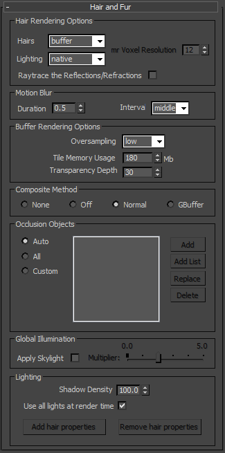

Interface
Hair Rendering Options group
Hairs drop-down list
Sets the method to be used for rendering hair:
  • buffer (The default) Procedural hair generated by Hair at render time based on the modifier parameters. Buffer hair is generated by a special renderer within Hair and offers the benefit of being able to create millions of hairs with minimal memory requirements. Only one hair is in memory at a time. Also, using Buffer render offers a variety of compositing options (described below).
  • geometry Creates actual geometry for the rendered hair at render time. This geometry is assigned the material ID set by the Hair And Fur modifier Geom Mat ID parameter.
    Note: “Geometry” hair derives its texture from the growth object, not from any maps applied via the Material Parameters rollout.
    Compositing options aren't available with “geometry” hair.
    The “geometry” option works with the default scanline renderer.
  • mr prim Hair is generated by a procedural shader that generates curve primitives directly into the rendering stream at render time.
mr Voxel Resolution Available only for the “geometry” and “mr prim” Hairs options. At render time, hair boundaries are subdivided into volume cubes or “voxels.” 3ds Max calculates which hairs are in each voxel, and when a ray enters a voxel, it calculates for those hairs. This allows unneeded voxels to be removed from memory during calculation.
With “geometry” rendering, voxels are used only for calculating instanced hairs.
This value gives the resolution of the subdivision. For example, a value of 3 subdivides the volume into 3 x 3 x 3 voxels, for a total of 27. The higher this value, the more efficient calculations can be. Default=5.
Lighting drop-down list
  • native (The default.) Uses standard 3ds Max calculations for light falloff.
  • emulation Performs a simpler internal calculation for light falloff within the buffer render. It applies only to the buffer hair rendering itself, not the 3ds Max scene. This mode omits features such as illumination textures on the hair, and light falloff calculation might be slightly inaccurate, but rendering is somewhat faster.
Raytrace the Reflections/Refractions
Available only for the “buffer” Hairs option. When on, reflections and refractions are ray-traced. When off, they are calculated as usual. Turning this option on can increase realism at the cost of render time. Default=off.
Motion Blur group
In order to render motion-blurred hairs, Motion Blur must be enabled for the growth object.
Duration
The number of frames over which motion blur is calculated for each frame.
Interval
The point in the duration at which the “snapshot” of the hair is captured, before blurring. The choices are “start”, “middle”, and “end”. The default is “middle”, which causes blurring to occur at the start and end of the duration.
Buffer Rendering Options group
These settings apply only to the ”buffer” rendering method.
Oversampling
Controls the level of antialiasing applied to the Hair “buffer” render. The available choices are “draft”, “low”, “medium”, “high”, and “maximum”. The “draft” setting uses no antialiasing; “high” is suitable for most final renders; in extreme cases, use “maximum”. The higher the Oversampling level, the greater the memory requirements and render time. Default=”low.”
Tile Memory Usage
Sets the maximum amount of main memory to be used by a “tile.” Hair And Fur renders hair one tile at a time. Default = 180 Megabytes.
Transparency Depth
Sets a maximum depth for rendering transparent or translucent hairs. Default=30.
Composite Method group
This option lets you choose the method by which Hair composites hair with the rest of the scene. Compositing options are available only with the “buffer” rendering method.
  • None Renders the hair only, with occlusion. The resulting image is ready to composite.
  • Off Renders hair shadows but not the hair.
  • Normal (The default.) Does standard rendering and composites the occluded hair with the rest of the scene in the Rendered Frame Window. Because of the occlusion, hair will not appear behind (through) transparent objects.
  • GBuffer Buffer-rendered hair appears behind most transparent objects. Transparent refractive objects aren't supported.
Occlusion Objects group
This setting lets you choose which objects will occlude hair in the scene; that is, if the object is closer to the camera than part of the hair array, the hairs behind it won't render. By default, all objects in the scene occlude hair behind them.
  • Auto (The default.) All renderable objects in the scene occlude hair behind them.
  • All All objects in the scene, including non-renderable objects, occlude hair behind them.
  • Custom Lets you specify the objects that will occlude hair. Choosing this option makes the buttons on the right slide of the list available. If you choose Custom but don't specify any occlusion objects, no objects will occlude the hair; that is, the hair will appear in front of all objects, whether or not it's closer to the camera than the objects.
[occlusion objects list]
The list of custom occlusion objects. To edit this list, choose Custom and then use the buttons on the right side of the list.
Add
Adds a single object to the list. Click Add and then in a viewport, click the object to add.
Add List
Adds multiple objects to the list. Click Add List and then in a viewport, click each object to add in turn. To finish, right-click the viewport or click Add List again to turn it off.
Replace
To replace an object in the list, highlight its name in the list, click Replace, and then in a viewport click the replacement object.
Delete
To remove an object from the list, highlight its name in the list and then click Delete.
Global Illumination group
Apply Skylight
When on, Hair And Fur supports takes sky light into account, provided it is present in the scene. Default=off.
Multiplier
Available only when Apply Skylight is turned on. This Multiplier value lets you adjust the amount of sky light that is used when rendering hair.
Lighting group
These settings control the illumination of hair and shadow-casting from hair by supported lights in the scene.
The following light types are not supported when rendering hair with the “buffer” method: Skylight, mr Area Omni, mr Area Spot, IES Sun, IES Sky, mr Sky and mr Sun. However, mr Area Omni, mr Area Spot, mr Sky, and mr Sun are supported for hair when you use the “mr prim” method.
Note: For the purposes of rendering shadows in hair, Direct lights are treated as point (omni) lights.
Shadow Density
Specifies the relative darkness of the shadows. At the default, highest value, 100.0, shadows are darkest. At the lowest value, 0.0, shadows are fully transparent, so they don't render. Range=0.0 to 100.0. Default=100.0.
Use all lights at render time
When on, causes all supported lights in the scene to illuminate and cast shadows from hair when the scene is rendered. (Shadows are cast only from lights whose Shadows toggle is on.) When off, for a light to cast shadows from hair, you explicitly must add hair properties. In either case, shadow maps for hair use the settings from the Hair Light Attr(ibutes) rollout Default=on.
Note: These settings apply only to “buffer”-rendered hair (the default type, set in the Hair Rendering Options group, as described above).
Add hair properties
Adds the Hair Light Attr(ibutes) rollout to selected lights in the scene. If you want to assign hair-specific shadow properties on a per-light basis, this rollout is necessary. Available only when at least one supported light is selected.
When Use All Lights At Render Time is off, only lights with hair properties can illuminate hair.
Remove hair properties
Removes the Hair Light Attr(ibutes) rollout from selected lights in the scene. Available only when at least one light with hair properties added is selected.
