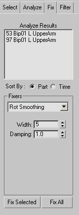

The results of last analysis are displayed in the Analyze Results list. Clicking an error in the list once displays the error as a yellow line over the curve; clicking the error twice updates the viewport scene, making the error the current frame. Errors can be sorted by Part or by Time.
Fixes can be applied to individual errors, selected errors, or to all errors at once.

Analyze Results error list
Displays all the errors the analyzer found for the selected body parts. The name of the Biped object is preceded by the frame number of the error. Clicking the error once displays a yellow line at that frame in the Curve View. Clicking it twice moves the current frame to match the error frame number: the viewports display that frame as well.
Sort by:
Lets you change the display of the error analysis results.
  • Part: Displays all the errors for each part listed together.
  • Time Displays all the errors sequentially, by frame.
Fixers group
[fixer options drop-down list]
Determines the method used to attempt to correct the errors found by the analyzer. In general, try to match the fixer to the analyzer property. For example, if you have selected a Noise detector with Rot Speed, then choose a Fixer with Rot in the name as well. The exception to this would be when it is obvious that you'd prefer to remove the keys rather than modify them. In that case, choose a Remove Keys fixer.
Fixer options include:
  • Rot Smoothing Corrects rotational errors by smoothing the curve. Can be repeated on the same track for greater effect. Slower than blurring, but keeps more detail of the curve.
  • Rot Blurring Corrects rotational errors by blurring the curve. Good if you just want to keep the general shape of the animation, but don't want to keep the details. May remove too much detail in the animation.
  • Adv Rot Smoothing Works even better than the normal smoothing filter when it comes to only modifying large changes. Can be repeated on the same track for greater effect. It is the slowest filter, great at keeping minute details, which can be very important, especially with motion-capture data when you want to keep nuances.
  • Pos Smoothing Corrects move transform problems by smoothing the curve. Can be repeated on the same track for greater effect. Slower than blurring, but keeps more detail of the curve.
  • Pos Blurring Corrects positional problems by blurring the curve. Good if you just want to keep the general shape of the animation, but don't want to keep the details. May remove too much detail in the animation.
  • Remove Keys Fixes errors by deleting keys based on an interval setting.
  • Knee Wobble Fixes knees that wobble or shake when a foot is planted. Uses a Knee Angle value as criteria for error status.
  • Knee Extension Fixes knees that overextend when a foot is planted. Uses a Fluctuation value as criteria for error status.
[fixer parameters]
Individual fixers display different parameters. These include:
  • Width Determines how much of the curve is affected around the keyframe.
    All the Fixers except for Remove Keys display this parameter.
  • Damping Determines how the fix is blended into the existing curve. Changes how effective the fixer should be. A higher value, the more dramatic the change. A damping value of 1.0 is normal behavior
