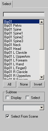

The Select panel of the Animation Workbench provides tools for selecting bipeds or biped components. You can manipulate the selected biped part's animation tracks via curves displayed in the Workbench, or by using the Analyze, Fix, and Filter panels to automatically identify errors and fix them.

To display a biped body part curve in the Workbench, do one of the following:
  1. On the Select panel, make sure Select From Scene is turned on, then in a viewport, click any biped object.
    The object's curve is displayed in the Workbench Curve window.
  2. On the Select panel of the Animation Workbench, click to highlight the name of the body part in the scrollable Selection list.
  3. On the Workbench toolbar, turn on Controllers. In the hierarchy list, highlight the body part track whose curve you want to see.

Interface
[selection field]
Enter the name of the biped part you want to locate. That name (if found) will be highlighted in the Selection list. This is useful when you can't find an entry by scanning the list.
You can use the question mark and asterisk characters as wildcards, in order to select multiple objects at once.
[selection list]
The selection list displays all the body parts of all the bipeds in the scene.
You can use the Shift, Ctrl, and Alt keys to build selection sets, as in the rest of 3ds Max.
All
Selects every entry in the list.
None
Clears the selection so nothing is highlighted.
Invert
Selects everything not highlighted in the list.
Subtree group
Display
Indents the list to show the biped hierarchy. Default=off.
Select
When on, selecting one biped part selects both it and all of its children. Default=off.
Named selection list
When you create a named selection in the scene, the named selection becomes available.
Select From Scene
When Select From Scene is on, you can click the biped body parts directly in the viewport, rather than from the list. The curves are immediately displayed in the Workbench Curve View. This is handy if you don't know the name of the part you need to select.
