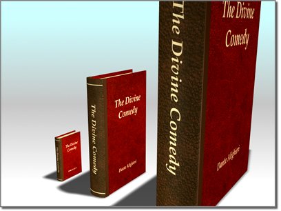

The Select And Uniform Scale button, available from the Select And Scale flyout, lets you scale objects by the same amount along all three axes, maintaining the object's original proportions.
  • Main toolbar > Select and Uniform Scale, on Select And Scale flyout
  • Right-click an object. > Scale (selects current toolbar Scale mode)
Uniform scale does not change an object's proportions.
To scale a single object, you don't need to select it first. When this tool is active, clicking an object selects it and dragging the mouse scales it.
