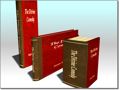

The Select And Non-Uniform Scale button, available from the Select And Scale flyout, lets you scale objects in a non-uniform manner according to the active axis constraint.
  • Main Toolbar > Select and Non-uniform Scale, on Select And Scale flyout
  • Right-click an object. > Scale (selects current toolbar Scale mode)
Non-uniform scale can change proportions with different values for different axes.
You can restrict scaling to a specific axis or plane by first clicking the appropriate button on the Axis Constraints toolbar, or with the Transform gizmo.
To scale a single object, you don't need to select it first. When this tool is active, clicking an object selects it and dragging the mouse scales it.
