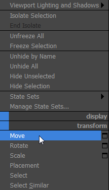

- Right-click the Perspective viewport and choose Move from the menu.
This right-click menu is called the quad menu. You can use it to access tools from the toolbar and command panel for quicker workflow. You can even customize it to keep your favorite tools right under your fingertips.

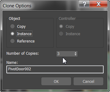

- On the Clone Options dialog, set Number Of Copies to
3, choose Instance (if necessary), and click OK.
Now there are four doors within the enclosure.
