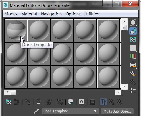

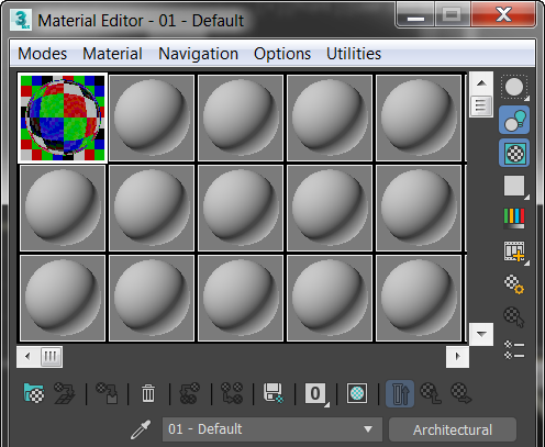

Open the material editor:
- On the main toolbar, choose
(Material Editor) from the Material Editor flyout to open the Compact Material Editor.
(A flyout is like a drop-down menu, but with buttons instead of text.)
The Material Editor opens as a floating window.

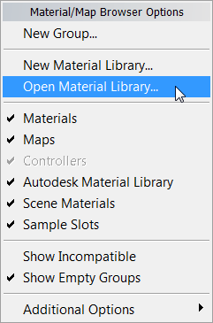

- On the Material/Map Browser, click
(Material/Map Browser Options) (or right-click an empty area of the dialog), and from the pop-up menu, choose Open Material Library.
3ds Max opens a file dialog.

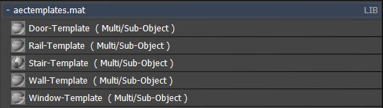

- Highlight the file
aectemplates.mat, and then click Open.
This library is located in the \materiallibraries subfolder of your current Project. If it doesn’t appear in the file dialog when you click Open, browse to this directory, then open the library.
Note: The filename extension for 3ds Max material library files is MAT.A section for the library now appears in the Material/Map Browser.
- In the Browser, double-click the material name
Door-Template.
The door material appears in the first sample slot of the Compact Material Editor.
Close the Material/Map Browser.
- Drag the material from the sample sphere to the door object in the viewport.
The door now displays with transparent glass. Also, in the Material Editor, the sample sphere is now marked with corners showing that this material has been applied to an object in the scene.

- Click any unused sample slot in the Material Editor to activate that slot.
By default, materials in the Material Editor are of the Architectural type. You'll change this material to the Standard type.

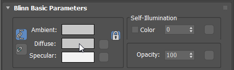

- On the Blinn Basic Parameters rollout, change the color of this material by clicking the Diffuse color swatch.
When the Color Selector opens, pick a green color.
Watch in the viewport; each time you click a different color, the material updates in the viewport. When you've decided on a color, click the OK button.
“Blinn,” named after computer-graphics pioneer James Blinn, is the default shader type used by the Standard material. A shader determines how the material interacts with light. And “Diffuse” refers to the basic material color. You can find more information about shaders and about materials in general in the 3ds Max Help.
- On the Blinn Basic Parameters rollout, change the Opacity value to
66.

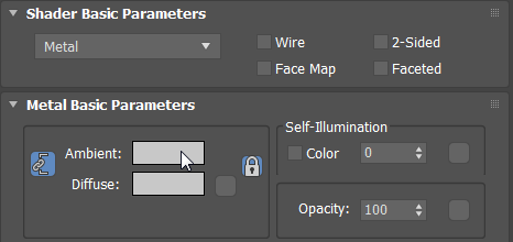

- On the Shader Basic Parameters rollout, click the drop-down arrow next to Blinn and choose Metal.
This shader is more appropriate for metallic materials.
- On the Metal Basic Parameters rollout, click the Ambient color swatch.
In the Color Selector, choose a dark color close to black. You can use the Whiteness slider to darken the color.
Note: The Diffuse color changes to the same dark color, since by default the Diffuse and Ambient values are locked together.“Ambient” refers to the lighting that spreads out within a scene without being cast directly by a light source. Typically it's reflected off surfaces such as walls.

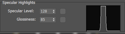

- Set Specular Level to
128 and Glossiness to
85.
These two settings determine the brightness and size of shiny highlights, respectively.
All of these settings combine to produce a black, shiny surface treatment.

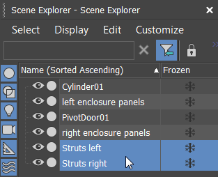

- In the Scene Explorer, click and
Ctrl+click to select the
Struts objects. If the Scene Explorer is not open, click
in the main toolbar, or press the
H key .
- In the Compact Material Editor, click
(Assign Material To Selection) to apply the material to the struts.

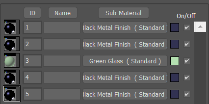

The sample sphere is replaced with a sphere that shows five stripes of different materials. This indicates that the selected material is a Multi/Sub-Object material.
On the Multi/Sub-Object Basic Parameters rollout, you can click and access each individual material.
- Drag the Green Glass sample sphere to the button labeled “Inner Bevel (Standard).” On the Instance (Copy) Material dialog choose Instance, then click OK.
When you copy something using the Instance option, changing one instance changes all of them. For example, if you then made the glass a neutral color, all the instances would reflect that change.
This is the material that is applied to the glazing. The glass on the revolving door turns green in the viewport.
- Drag the Black Metal Finish material to the other material slots of the Multi/Sub-Object material. In each case, choose Instance.
After you created the pivot door, you assigned a Multi/Sub-Object material from a material library to the door. When you have a single object, such as this door, with different, distinct components (such as glazing, frame, and so on), you can use a Multi/Sub-Object material to apply different materials to its various parts.
