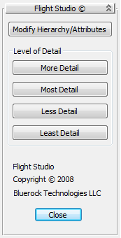

With the Flight Studio utility, you can manage OpenFlight models from within 3ds Max.
Modify Hierarchy/Attributes
Click to open the Hierarchy Browser dialog.
Level Of Detail group
These buttons use the OpenFlight level-of-detail (LOD) range to display more or less detail in 3ds Max viewports.
More Detail
Increases by one level the amount of detail shown.
Less Detail
Decreases by one level the amount of detail shown.
Most Detail
Shows the most detail in the imported model.
Least Detail
(The default.) Shows the least detail in the imported model.
