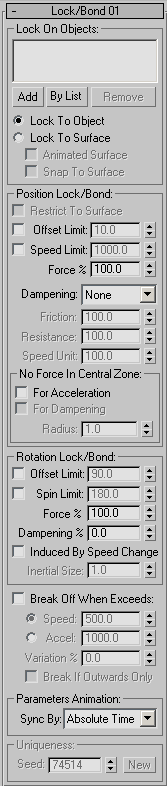

Interface
Lock On Objects group
The controls in this group set the starting point for the Lock/Bond test. Here you specify the objects to which to attach the particles, and choose the method for placing particles as they enter the event.
When the Lock/Bond test starts, each particle is locked to a specific point in the scene, usually on the object's surface. This point is referred to as the particle's lock point. If the object is animated, the lock points animate along with the object. When Snap To Surface is turned on, the lock point is on the surface. When Snap to Surface is off, the lock point is exactly at the point where the particle is located at the moment when it enters the event. This location is translated to the local coordinates of the reference object, and maintained throughout the animation of the reference object.
[list]
Shows all objects referenced by the test.
Add
Adds an object to the list.
By List
Allows you to add multiple objects to the list.
Remove
Removes highlighted objects from the list.
[locking method]
Choose a method for locking particles to objects in the list:
  • Lock To Object Locks particles to the object's local coordinate space. This option takes less processing time than Lock To Surface.
  • Lock To Surface Locks particles to the closest point of the object's surface at the moment when the particle enters the event.
    By default, this option maintains the distance each particle had from the surface upon entering the event. When used in conjunction with Snap To Surface, this option locks particles to the actual object surface.
    Lock to Surface takes more processing time than Lock to Object because the software has to find the closest point on the surface for each particle.
Animated Surface
Locks particles to a changing surface. Use this option when the object's surface changes shape or detail over time, such as with animated sub-objects or parameters, morphing, or a skinning modifier. If the object is animated through transforms only (position/rotation/scale), you can save processing time by leaving this option off.
When on, the operator acquires the surface data at every frame. When off, the operator acquires the surface data only once, and uses transformation data as needed to calculate the surface location at every frame.
Available only when Lock To Surface is on.
Snap To Surface
Causes particles to jump to the object's surface as they enter the event. This option differs from Lock To Surface, which locks particles to the surface but maintains each particle’s distance from the surface upon entering the event. Snap To Surface forces particles to lie on the object's surface.
If you turn on Snap To Surface but not Restrict To Surface (see following), particles jump to the surface upon entering the event, but don't stay on the surface if Force in the Position Lock/Bond group is less than 100% and other forces such as the Speed operator or Force operator are applied.
These options control the movement of particles from their lock points after they enter the event.
Restrict To Surface
Forces particles to stay on the object's surface as they move. When the Force parameter is less than 100%, particles can move from their original positions based on Speed and Force operators within the event. In this case, turning on Restrict to Surface forces the particles to move only to other parts of the surface without leaving the surface itself.
For more information on how Restrict to Surface works with the Force parameter, see Force, following.
Offset Limit
The maximum distance a particle can move from its lock point, in units. When off, particles are not limited in their movement.
If the object or surface is animated, particles might need to move quickly to keep up with the lock point's animation and stay within the Offset Limit distance. If Offset Limit is on and particles cannot keep up with the lock point's movement, particles will be limited to be within the Offset Limit distance to the lock point (to the Offset Limit) even if Force is less than 100%. In addition, if Speed Limit is on, particles can exceed the speed limit to maintain the specified offset. In other words, the Offset Limit parameter, when on, overrides the Speed Limit parameter.
Speed Limit
The maximum speed a particle can travel, in units per frame. If Speed Limit is on and particles cannot keep up with lock points on an animated object, particles are limited to the Speed Limit even if Force is 100%. In other words, the Speed Limit parameter, when on, overrides the Force % parameter.
Force %
Sets the amount of force holding the particle to its lock point. A Force % value of 100.0 attempts to keep particles stuck to their lock points. If the Force % value is less than 100.0, particles can move off their lock points based on Speed and Force operators in the event. The lower the Force % value, the more influence Speed and Force operators have on the particles.
If Force % is less than 100.0 and Restrict To Surface is on, particles move along the object's surface. If Force % is less than 100.0 and Restrict To Surface is off, particles move off the surface but retain their relationships to lock points. In either case, particle movement is based on Speed and Force operators, and is restricted by Offset Limit and Speed Limit if those parameters are on.
When Force %=100.0 and Restrict To Surface is on, particles are locked strictly to the object or surface, and do not move. If Force %=100.0 and Restrict To Surface is off, particles are locked to the object unless Break Off When Exceeds is on and the object is animated at a sufficient speed to break off particles.
Note: Offset Limit and Speed Limit, when enabled, can override a 100% Force setting.
Dampening
Defines how particles are slowed down, whether moving on the object's surface or off it. Dampening simulates the effect of various resistance forces.
  • None No dampening is applied, other than the default dampening on oscillating forces from Speed and Force operators.
  • Friction Simulates a surface friction effect, which gradually slows particles until they stop moving. The total slowdown is proportional to the travel distance of a particle. The number of seconds in which a particle loses its speed is equal to initial speed divided by the Friction value. For example, if the initial speed of a particle is 300.0 and the Friction value is 100.0, then the particle gradually comes to a halt over three seconds.
  • Air/Fluid Simulates the resistance of a medium such as air or water, which slows particles but never stops them completely. The resistance is proportional to the speed squared, making the resistance very high for fast-moving particles, but quite low for slow-moving particles. For example, if one particle is moving at a speed of 100.0 and another at 200.0, the resistance for the faster particle will be four times larger than for the slower particle. The Resistance value defines the resistance force for a particle with speed equal to the Speed Unit value.
  • Both Combines both forces: Friction and Air/Water. If you want the overall effect of air resistance, but you want particles to stop moving eventually, use this option. In this case, a small Friction value stops slow-moving particles.
No Force In Central Zone group
The central zone is a volume around a lock point. Each particle has its own central zone defined by the Radius parameter in this group.
When Force % is less than 100.0, particle movement is influenced by Force and Speed operators, where forces are oscillated and particles gradually slow down until they come to rest. If you want particles to wander around the lock point rather than coming to rest, you can use these settings to disable forces in each particle's central zone. This will keep a particle wandering indefinitely if its location is within the Radius of its lock point.
Acceleration
When on, turns off acceleration forces in each particle's central zone. This prevents the particle from slowing down to a stop.
Dampening
When on, turns off dampening in each particle's central zone. This prevents particles from being slowed by friction and coming to a stop.
Rotation Lock/Bond group
Use these options to control the rotation of particles. In this section, mentions of the Force % parameter refer specifically to the one in this group.
Offset Limit
The maximum number of degrees by which a particle can deviate from its lock point's rotation. For example, the maximum number of degrees a particle can lean or bend when affected by Wind or Gravity.
If the object or surface is animated, particles might need to rotate quickly to keep up with the lock point's rotation and still remain within the Offset Limit. If Offset Limit is on and particles cannot keep up with the lock point's rotation, particles will be limited to the Offset Limit even if Force % is less than 100.0. In addition, if a Spin Limit is set (see following), particles can exceed the Spin Limit to maintain the specified offset. In other words, the Offset Limit, when on, overrides the Spin Limit.
Spin Limit
The maximum number of degrees per frame that a particle can rotate. If Spin Limit is on and particles cannot keep up with lock points that are rotating, particles will be limited to the Spin Limit even if Force %=100. In other words, the Spin Limit, when on, overrides the Force % setting.
Force %
The amount by which the particle's rotation is forced to match its lock point's rotation. When Force %=100.0, particles maintain their original orientations, unless limited to rotate by Spin Limit settings. When Force % is less than 100.0, particles can be rotated with Force operators. The lower the Force value, the more a particle can be influenced by Force operators and inertial properties of a particle.
Dampening %
The amount of resistance that prevents a particle from catching up with the lock point's rotation. A value of 0.0 creates no dampening, while 100.0 keeps the particle from rotating at all. If Offset Limit is on, Dampening cannot cause the particle rotation to deviate from the lock point's rotation by more than the Offset Limit amount, even if Dampening % is set to 100.0. In other words, the Offset Limit setting overrides the Dampening value.
Induced By Speed Change
Causes particle rotation to occur even when particles' positions are locked to their lock points. For example, a field of grass particles would not move, but could rotate when wind is applied to them.
This option also works with particles locked to animated surfaces, such as hair or fur particles on an animal's body. Usually particles are rotating because the underlying surface is rotating, and particles are trying to catch up with the "lock" orientation. This option lets you simulate the effect of a particle with a springy attachment to a surface. Since the center of gravity of a particle doesn't coincide with the lock point, any movement of the underlying surface initiates a rotational movement of a particle.
Inertial Size
The distance between the pivot point of a particle and the particle’s center of gravity. For example, the inertial size of a blade of grass is half the length of the strand. Smaller values induce a stronger rotation. Available only when Induced By Speed Change is turned on.
Causes particles to be released from an object's surface when they achieve a specific speed or acceleration. This option works only when particles are glued to the object's surface and have no speed of their own, and any speed or acceleration comes from animation of the object itself.
Particles that break off from the object become available to the Lock/Bond test output, which you can wire to another event.
You can use either of the following settings with this option:
  • Speed The particle speed at which a particle breaks off the object.
  • Accel. The particle acceleration at which a particle breaks off the object.
Break If Outwards Only
Causes particles to break off only when the particle's motion is directed away from the object's surface, in the direction of the nearest surface normal. Particles that would penetrate the object when breaking off are not released from the object. Available only when Lock to Surface is chosen and Break Off When Exceeds is on.
Parameters Animation group
You can animate Lock/Bond parameters. When you do, Particle Flow can begin applying the animation to particles at different times, depending on the settings in this group.
Sync By
Choose the time frame for applying animated parameters:
  • Absolute Time Any keys set for parameters are applied at the actual frames for which they're set.
  • Particle Age Any keys set for parameters are applied at the corresponding frames of each particle’s existence. For example, suppose you set keys for the Offset Limit parameter at frames 0 and 30. With the Particle Age option, the settings for the first key would be applied to particles at birth, and the second key would be applied 30 frames later.
  • Event Duration Any keys set for parameters are applied to each particle relative to the frame at which it first enters the event. Use this option when particles are entering from another event. If particles are born in the current event, this option has the same effect as the Particle Age option.
Uniqueness Group
These controls set randomization for the Randomly Selected and Select By Particle Property selection conditions.
Seed
Specifies a randomization value.
New
Calculates a new seed using a randomization formula.
