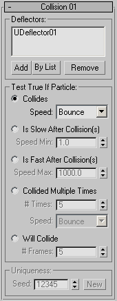

Interface
The user interface appears in the parameters panel, on the right side of the Particle View dialog.
Deflectors group
This group displays the deflectors currently in effect, and let you add and remove deflectors.
[list]
Shows the deflectors that apply to this operator. If more than three deflectors apply, a scroll bar appears at the right side of the list.
If you delete a listed space warp from the scene, its name is replaced in the list by the entry “<deleted>”.
Add
Click this button, and then select a Deflector space warp in the scene to add it to the list.
By List
Click this button, and then use the Select Deflectors dialog to add one or more space warps to the list. The space warps must already exist in the scene.
Remove
Highlight a deflector in the list, and then click this button to remove it from the list. Any removed space warps remain in the scene.
Test True If Particle group
Choose the condition under which the test will pass particles on to the next event, and then adjust the associated setting or settings.
  • Collides (The default.) Choose this option, and then set Speed according to how particle speed should be affected by the collision.
    Speed Choose one of the following:
    • Bounce (The default.) The speed and direction after collision is determined by the deflector properties.
    • Continue Particle speed and direction are unaffected by the collision.
    • Stop Particle speed is set to 0 after the collision.
    • Random Particles bounce off the deflector in random directions.
  • Is Slow After Collision(s) The test succeeds if, after collision, particle speed is less than the Speed Min value.
    With this choice, particle behavior with respect to the deflector(s) is the same as with the Collides Bounce option.
    Speed Min Particles traveling at less than this speed, in system units per second, test True and become eligible for moving to the next event. Default=1.0.
  • Is Fast After Collision(s) The test succeeds if, after collision, particle speed is greater than the Speed Max value.
    Speed Max Particles traveling faster than this speed, in system units per second, test True and become eligible for moving to the next event. Default=1000.0.
  • Collided Multiple Times The test becomes True after a particle collides a specific number of times. The particle is moved to the point of the last collision and then redirected to the next event.
    # Times The number of times a particle must collide in order to test True.
    Speed Determines speed and direction after the specified number of collisions. See above for explanations of the choices.
  • Will Collide
    Particle Flow extrapolates particle motion in a linear fashion, based on the current direction and speed, and the test becomes True if the results suggest that the particle will collide with the deflector during a specified time interval. The particle is redirected to the next event without updating its speed or position.
    # Frames The number of frames ahead during which Particle Flow looks for an impending collision.
Uniqueness group
The Uniqueness setting enables randomization of the Random options in the Speed drop-down lists.
Seed
Specifies a randomization value.
New
Calculates a new seed using a randomization formula.
