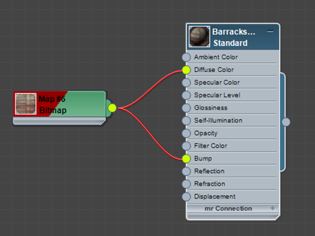

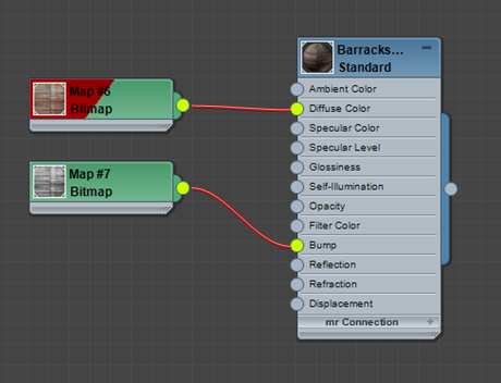

A material with one map for diffuse color and another as the bump map
A material with a single map used as both diffuse color and bump maps
