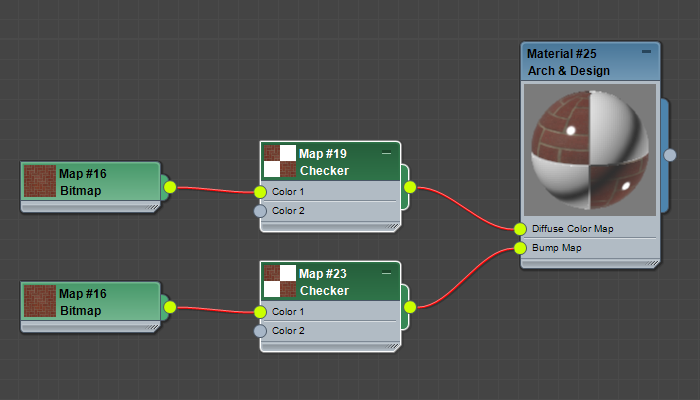

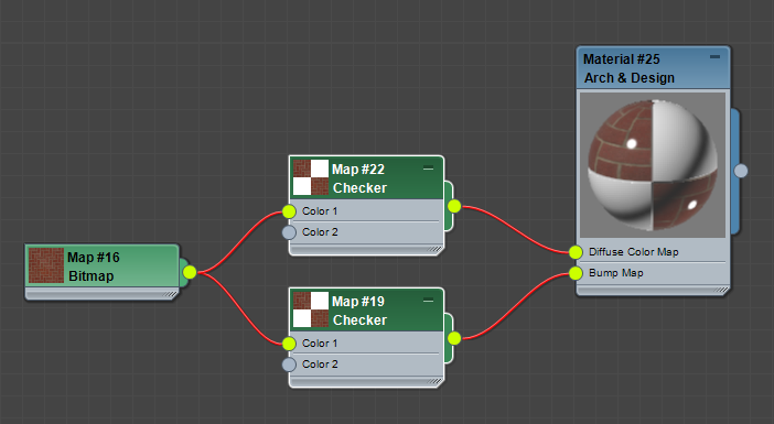

An instanced map
(Branching wires always indicate instancing.)

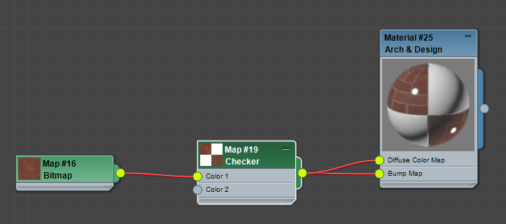

After right-clicking a wire between the bitmap and material, and choosing Make Node Unique
After right-clicking a wire between the bitmap and material, and choosing Make Branch Unique
