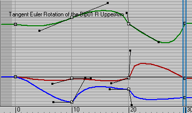

Tangent Euler Rotation curve

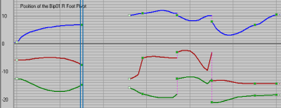

Displaying Position Curves
Bezier position curves are available only for the biped's hands, feets, and center of mass (COM). Hands and feets' positions are set in world space while the COM position is set local to the world.
FK/IK key blending is illustrated as follows:
  • Full lines represent IK periods.
  • Gaps between lines represent FK periods.
  • Vertical dotted lines represent a change in pivot points.
Note: Keys set to Join to Prev IK Key are locked in value until the next un-joined key.

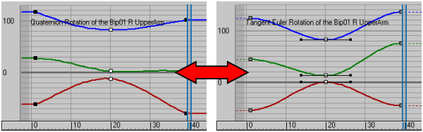

Curve Conversion Between Quaternion and Euler
When an animation converts from one controller to the other, its integrity is maintained as much as possible. This means that despite variations in key interpolation results, the keyframed poses are preserved.
If you convert a quaternion rotation curve to Euler, the resulting tangent keys are set to Smooth. If, on the other hand, you switch an Euler rotation curve to quaternion, the bezier interpolation from the tangents is maintained as much as possible. However, if that interpolation is too extreme and can not be matched by TCB values, it is then reduced to fit under quaternion limits.
