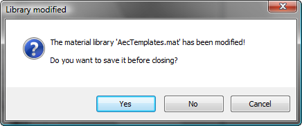

  3. In the Material/Map Browser panel, right-click the library file entry and choose Close Material Library.
    3ds Max asks if you want to save changes to the library. Click Yes.
