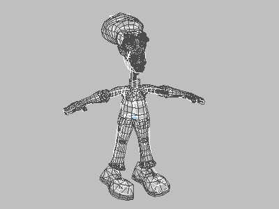

Usually you create the Physique skin before you create the skeleton, because you must adapt the skeleton's dimensions to the dimensions of the skin, in order to optimize vertex assignment to the links in the hierarchy.
This Physique hierarchy is created with dummy objects linked to each other.
Physique mesh with a biped skeleton.
