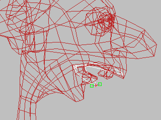

Floating Bones
Floating bones are bones that are not linked together and know nothing about each other. By adding floating bones to Physique, you can deform the mesh by animating the bones. This is in contrast to using Attach To Node and clicking the root of a hierarchy, like the biped pelvis. For Attach To Node to work all the bones should be linked together.

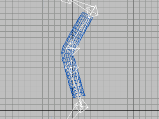

Spline-Based Physique Deformation
In addition to the biped and 3ds Max bones, Physique supports spline and NURBS curves for mesh deformation. By animating vertices on a spline, you can animate the mesh. You can use this technique for facial animation or to deform any mesh.
To control a mesh with a spline:
  1. Place a spline inside a mesh.
  2. Select the mesh and apply the Physique modifier.
  3. In the Physique Floating Bones rollout, click Add and in a viewport, pick the spline.
  4. Select the spline, go to the Vertex sub-object level, and move the spline vertices to animate the mesh.
