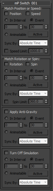

Interface
Match Position or Speed group
Use these settings to adjust the simulated positions or speeds of particles. The MassFX engine calculates the simulated motion of the particles in the event, but if Position or Speed is on, then the position or speed particle properties, as defined by regular (non-mParticles) operators, affect the simulation.
Position/Speed
A single mParticles Switch operator can allow non-mParticles actions in the event to affect particle positions or speeds, but not both. Choose one or the other, and then adjust the remaining group controls as necessary. Only one of these can be on; to disable, click the active check box.
Position
Particle position, as defined by a position-type operator, is used to calculate the necessary force to be applied to a particle in order for the particle to get to the specified position. The force is then applied to a particle in the MassFX engine. This way the desired particle placement is achieved by physics-simulation means.
Speed
Particle speed, as defined by a speed-type operator, is used to calculate the necessary force to be applied to a particle in order for the particle to achieve the desired velocity. The force is then applied to a particle in the MassFX engine. This way the desired particle speed is achieved by physics-simulation means.
Tip: For the mParticles Switch position/speed matching to take effect, place the mParticles Switch operator above the mParticles World operator in the event. Also, place the position- or speed-type operators that define the particle properties to match above the mParticles Switch operator. This way the desirable position/speed is calculated first, then mParticles Switch calculates the necessary forces to be applied to a particle and relays the information to an mParticles World operator.
Also, in general, avoid using an mParticles Force operator in the same event, as it can disturb position/speed matching because both the mParticles Force and mParticles Switch operators use forces applied to particles for motion simulation.
[Duration]
Choose whether the Position/Speed option should be in effect throughout the event, or during a specified frame range, or during explicit intervals. When using In Interval or Animatable, also set the Sync By option to determine how to apply the frame range(s).
  • In Interval The position/speed matching occurs only during the specified frame range.
  • Event The position/speed matching occurs throughout the event containing the mParticles Switch operator.
  • Animatable When you choose this option, the Active button becomes available. You can animate toggling of the Active button with standard keyframing methods to specify multiple frame ranges during which the Position or Speed switch control is active.
Sync By
When using the In Interval or Animatable option, use Sync By to choose the time frame in which to apply animation of the damping factors: Absolute Time, Event Duration, or Particle Age. For details, see Animation Offset Keying group.
Speed Limit
When using the Position option, use this to specify the maximum allowed particle speed while mParticles Switch tries to achieve the declared position via simulation. Turn on Speed Limit and use the numeric field to set the maximum speed.
Match Rotation or Spin group
Use these settings to adjust the simulated rotations or spin rates of particles. The MassFX engine calculates the simulated motion of the particles in the event, but if Rotation or Spin is on, then the operator calculates torque forces to be applied to particles to match the effect of rotation/spin-type operators above the mParticles Switch operator in the event. These controls work the same as those in the Match Position Or Speed group; for details on all controls except Spin Limit, see the preceding section.
Spin Limit
When using the Rotation option, specifies the maximum allowed particle spin in degrees per second while MassFX Switch tries to achieve the declared rotation via simulation.
Apply Anti-Gravity group
If the mParticles World operator has the Apply Gravity option on, you can turn on Apply Anti-Gravity to relieve particles temporarily from the effect of gravity. The timing of "gravity relief" is defined by the time parameters in this group, similar to the timing setup in the Match Position Or Speed group (see preceding).
For a video showing the effects of the Apply Anti-Gravity option, see Apply Anti-Gravity.
Turn Off Simulation group
You can use this option to convert the particle simulation temporarily from dynamic to kinematic. Dynamic particles' animation and movement is defined by the MassFX simulation, while the animation of kinematic particles is driven instead by the standard Particle Flow operators. However, kinematic particles can influence dynamic particles because the shape and motion of kinematic particles is accounted for in the simulation: Kinematic particles can collide with dynamic particles, thus affecting their simulated motion.
The MassFX engine does not control motion of the kinematic particles, so their shapes can overlap. This can create a potential problem if particles are kinematic in one event and dynamic in the next. The shape operator can create a "motion explosion" when the particle move to the next event, because MassFX engine has to resolve the overlapping of collision shapes that occurred while particles were kinematic.
The Turn Off Simulation timing can be controlled by the timing parameters in the group, similar to the timing setup in the Match Position Or Speed group (see preceding).
For a video showing the effects of the Turn Off Simulation option, see Turn Off Simulation.
