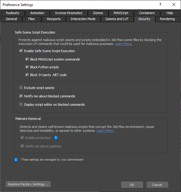

    When a setting is controlled via the registry, it is disabled on the Preferences dialog, and an icon indicates it is managed by a system administrator.

    Malware Removal Locked by Administrator

  • In 3ds Max 2022 and higher: See the "Enable Protection" option in the Malware Removal group in the Security tab of the Preferences dialog.

    • In 3ds Max 2022 and higher: See the "Notify me about updates" option in the Malware Removal group in the Security tab of the Preferences dialog. When enabled, a notification appears in the Security Messages dialog when an update is available, with a link to the Autodesk App Store, where you can download the update.
