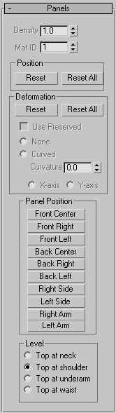

The Panels sub-object level of the Garment Maker modifier lets you position and bend the panels of your pattern to fit your object or figure.
You can also use these controls to adjust the texture mapping of your garment.
Interface
- Density
Controls the mesh density of a selected panel. This value is applied as a multiplier of the Main Parameters rollout
Density setting. You can increase the density of a particular panel by raising this value. If Main Parameters rollout
Auto Mesh is off when you change this value, go back to the Main Parameters rollout (Cloth level in modifier stack) and click Mesh It! to update the mesh. For this reason, it is recommended that you leave Auto Mesh on. The only time you might want to turn off Auto Mesh is while creating the seams at the Curves sub-object level. Re-meshing can take some time, so you might want to define a number of seams before re-meshing.
Different Density settings applied to separate panels
- Mat ID
Set the material ID for the selected panel. Using this option enables you to assign different materials to select portions of the clothing.
Position group
- Reset
Resets the position of the selected panels to their original locations (that is, the locations immediately after Garment Maker was applied).
- Reset All
Resets the position of all panels to their original locations.
Deformation group
Most controls in this group are available only when one or more panels are selected.
- Reset
Removes the deformation of the selected panels (restoring the flat state).
- Reset All
Removes the deformation from all panels.
- Use Preserved
Turn this on to override the None or Curved deformation options. When on, the panel gets its shape from the preserved mesh instead of the deformation options.
- None
Makes this panel flat.
- Curved
Use the value in the Curvature field to bend the panel.
- Curvature
Sets the amount of curve or bend of a panel. The higher this value is, the more the panel will curve.
- X-axis
Sets the axis for the curvature to the panel's local X axis.
- Y-axis
Sets the axis for the curvature to the panel's local Y axis.
Panel Position group
These buttons move the selected panel to a specified position. These positions are determined by 3ds Max based on the positions you set with the Mark Points On Figure controls at the Garment Maker object level. The positions are:
- Front Center
- Front Right
- Front Left
- Back Center
- Back Right
- Back Left
- Right Side
- Left Side
- Right Arm
- Left Arm
Level group
Sets where the top of the panel should go. Garment Maker derives these locations from the locations you specify with the Mark Points On Figure controls. The choices are:
- Top at neck
- Top at shoulder
- Top at underarm
- Top at waist
If you change the setting here, it affects the subsequent Panel Position results.
