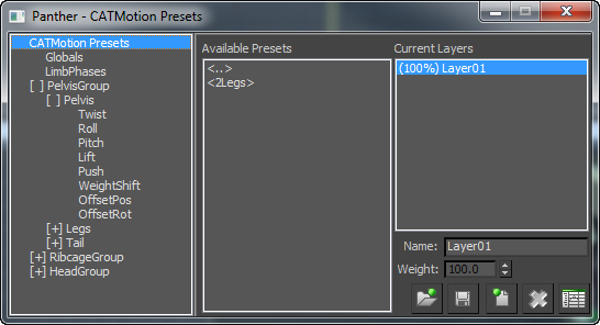

A CATMotion preset comprises the settings for all CATMotion controllers for a particular motion cycle. This data is contained in a CATMotion layer, which is different from the animation layers found on the Layer Manager rollout. You can save and load individual layers using text files with the extension .cmp.

To load a CATMotion preset:
  1. If you want to replace an existing layer with the loaded preset, highlight the layer to replace in the Current Layers list.
  2. In the Available Presets list in the CATMotion Editor, navigate to the preset to load and double-click its name.
    The Options dialog opens.
  3. Choose whether to create a new layer or to replace the existing (highlighted) layer with the new one.
    After you load a preset, its name appears in the Current Layers list on the right-hand side of the dialog. The name is highlighted, and the preset has a weight of 100%.
The preset is now loaded and in effect.

Available Presets
This list shows the CATRig presets in the current folder. You can navigate up to other folders by double-clicking the <..> symbol at the top of the list.
Current Layers
This list shows the currently loaded layers/presets of your CATMotion layer. If the Current Layers list contains multiple layers, you can view and edit a layer/preset by clicking on it, so the curves for that layer/preset will be active in the CATMotion hierarchy, ready for editing.
Note: The advantage of having multiple layers in the Current Layers list within a single CATMotion layer is that you can blend seamlessly between different walk cycles while still controlling the whole walk sequence with a single set of footprints. This means you have non-sliding footsteps even while blending between different walk cycles (for example, walk/run/sneak). If you used multiple CATMotion layers in the Layer Manager instead, blending between the CATMotion layers would result in sliding footsteps and a lot of unnecessary footprints.
Name
The name of the highlighted layer.
Weight
The weight of the highlighted layer.
Open CATMotion Preset
Click to browse for a preset.
Save CATMotion Preset
Save the settings of the highlighted CATMotion layer as a new preset.
Add CATMotion Layer
Create a new default CATMotion layer to edit.
Delete CATMotion Layer
Delete the highlighted layer.
