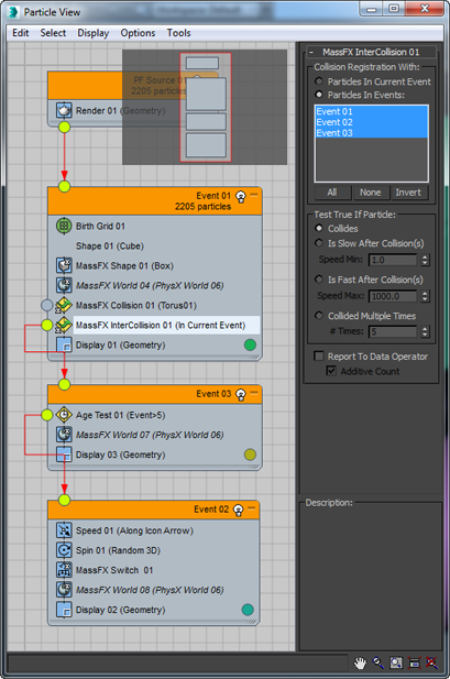

To illustrate the point about the collision Registration scope, consider the following example: MassFXInterCollision01.max.
In this example, at first all particles form a box, and then fall onto a torus deflector. The first event, Event 01, contains two tests: mParticles Collision to define collision with the torus deflector, and mParticles InterCollision to define jump to the next event when particles collide with each other. Keep in mind that the Collision Registration scope is set to Particles In Current Event. Therefore, it possible for some unlucky particles not to collide with any other particles before all neighbors already collide with each other and are transferred to the next event. As you can see, in this configuration there are particles that are "left behind," and stay green in color (as in the first event).
To make all particles eventually transition to the next event, change the Collision Registration scope to Particles In Events and highlight all three events in the list: Event 001, Event 002, and Event 003. Now when you play the animation, every particle gets a collision notification and changes from green to yellow to blue.
One more note about the example MassFXInterCollision01.max; Once particles get to the last event, they become static by turning off the simulation (see the mParticles Switch operator in the last event). The static nature of these particles put some particles that are "left behind" (the green ones) into an impossible situation: They are squeezed between static particles, and there is no enough room for their placement. That is why you can see jittering motion in the green particles.
You can avoid this jittering by adjusting the mParticles Switch operator in the last event. Instead of turning off the simulation, you can turn on Match Position. This way, particles from the last and first events all participate in simulation. They are, in a sense, equal for simulation purposes: All are dynamic. Therefore, some "spare room" is available for the green particles, and an equilibrium placement is achievable.

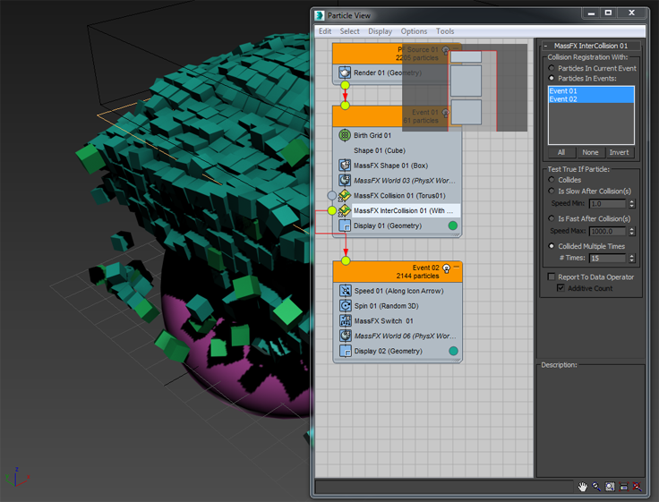

To illustrate the difference between the Collides and Collided Multiple Times options in the Test True If Particle group, look at another example: MassFXInterCollision02.max. This example contains two events, and particles are redirected to the second event if they collide with each other 15 times, according to # Times option. In the next event, particles are set to be static: Speed and Spin are equal to 0. The Speed and Spin values are set by regular Particle Flow operators (Speed 01 and Spin 01), but to make the particles static, a mParticles Switch operator is used.
If you play the animation, you can see that not all the particles were able to get the second event. This is because some of them did not collide at least 15 times during the course of the animation. As an exercise, decrease the # Times value to find how high this value can be while ensuring that all particles are transferred to the next event. This value is the smallest number of times a particle collides with other particles during the animation. Also, note that Collision Registration scope is set to Particles In Events, with all events highlighted. In this example, that means that we count all interparticle collisions.
