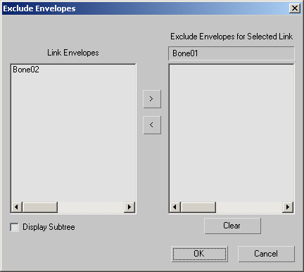

Exclude Envelopes Dialog
At the Envelope sub-object level, this dialog lets you exclude links from influencing other links. For example, you can exclude the right thigh link from influencing the left thigh link. Or, rather than scale the index finger envelopes to avoid influencing middle finger vertices, you might exclude the middle finger links from the index finger links.
  • Select an object that has the Physique modifier applied to it. > Modify panel > Envelopes sub-object level > Select an envelope. > Blending Envelopes rollout > Edit Commands group > Click Exclude.
Tip: You can leave this modeless dialog open while you choose links in the viewports.
Note: If you have a Physique model created with character studio 1 or 2 , excluding links will not work until you reinitialize Physique using the initial skeleton pose. In the Physique Initialization dialog, make sure Vertex-Link Assignments is turned on.
Interface
Link Envelopes list (left side)
Displays the links available for exclusion. Selected links are not in this list.
Exclude Envelopes for Selected Link list (right side)
Displays envelopes to exclude from the current link selection. The text field displays the name of the selected link, or “Multiple Links Selected.”
Right arrow
Select links in the Link Envelopes List on the left, then click the right arrow to add them to the Exclude Envelopes For Selected Link list on the right.
Left arrow
Select links in the Exclude Envelopes For Selected Links list on the right, then click the left arrow to remove them from the exclusion list.
Display Subtree
When on, the Link Envelopes list increments links according to their level in the hierarchy. This visual aid can help you to find and select links. Default=off.
Clear
Clears all links from the Exclude Envelopes For Selected Link list.
