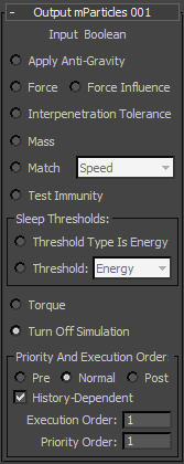

The Input mParticles suboperator is for sending data output to the MassFX engine when creating custom Particle Flow operators. This feature is intended for use with the Data operators.
  • Particle View > Add or select Data operator. > Click Edit Data Flow. > Data View > Add or select Output mParticles suboperator.
Interface
Apply Anti-Gravity
This Boolean data channel defines, on a per-particle basis, which particles can be excluded from the gravity force.
Force
Provides direct control over the forces applied to a particle, letting you modify the force applied to a particle without using a mParticles Force operator in the flow.
Force Influence
Defines an influence parameter for a mParticles Force operator that follows the Data operator in the event.
Note: In order to use these data, the mParticles Force operator must use Script Wiring (right-click the mParticles Force operator and choose Use Script Wiring), and Influence Parameter Wiring on the Script Wiring rollout must be set to From Data Operator.
Interpenetration Tolerance / Mass
Use these options to define Collision Shape Interpenetration Tolerance and particle mass values on a per-particle basis. If these data change from frame to frame, then particle mass/tolerance value will be adjusted continually.
Match
Writes different check box values defined by a mParticles Switch operator. The choices are Position, Rotation, Speed, Speed Limit, Spin, and Spin Limit.
Test Immunity
Writes Boolean values used by mParticles tests (mParticles Collision, mParticles InterCollision, and mParticles Glue) to suspend particles in their current event, even if they test as True and would normally be redirected to the next event.
Sleep Thresholds
Writes sleep threshold values for use by the mParticles World driver.
Torque
Similar to the Force option (see preceding), writes the torque value for use by an Output mParticles suboperator.
Turn Off Simulation
Writes whether the simulation is off for a particle—in effect, its kinematic status for use by a mParticles Switch operator.
The History-Dependent and Execution/Priority Order settings at the end of the Output mParticles rollout are the same as with any regular Output suboperator; for details, see Priority and Execution Order.
