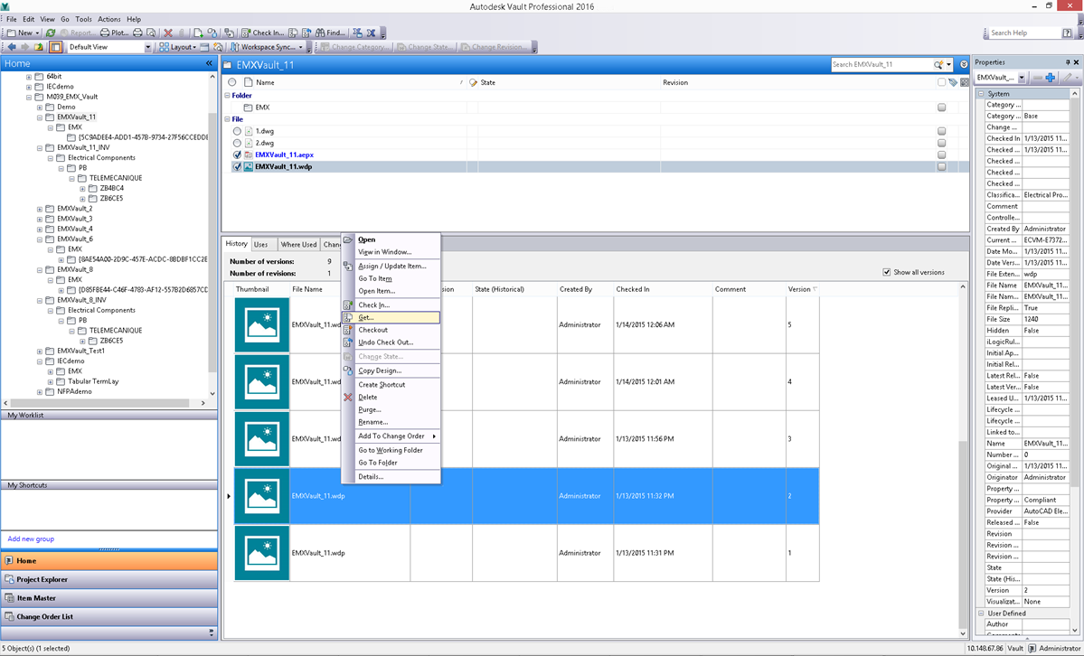

- In the Autodesk Vault Explorer, select the AutoCAD Electrical toolset project file. You can view the summary of the file in the Details pane.
- Select the History tab to view the file version history. Right-click on version 1 and select Get.

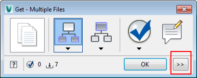

- In the Get dialog box, click Expand to Show Details.

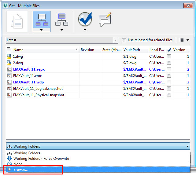

- Browse and select a new folder to save the files.
