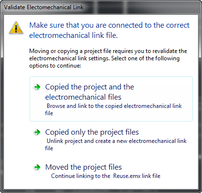

- In the Validate Electromechanical Link task dialog box, select the appropriate option to validate your electromechanical link settings for the copied project.
