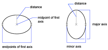

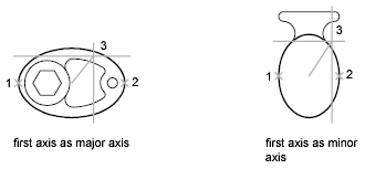

When you draw an ellipse, its shape is determined by two axes that define its length and width: the major (longer) axis and the minor (shorter) axis.
The illustrations below show two different ellipses created by specifying axis and distance. The third point specifies only a distance and does not necessarily designate the axis endpoint.
