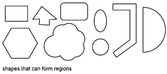

Regions are 2D enclosed areas that have physical properties such as centroids or centers of mass. You can combine existing regions into a single, complex region.
Regions can be used for
  • Extracting design information
  • Applying hatching and shading
  • Combining simple objects into more complex ones with Boolean operations.
You can create regions from objects that form closed loops. Loops can be combinations of lines, polylines, circles, arcs, ellipses, elliptical arcs, and splines that enclose an area.

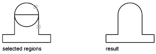

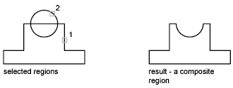

You can create regions by unifying, subtracting, or intersecting them:
Objects combined using UNION:
Objects combined using SUBTRACT:
