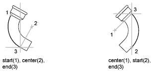

Draw Arcs by Specifying Start, Center, End
You can create an arc using a start point, center, and a third point that determines the endpoint.
The distance between the start point and the center determines the radius. The endpoint is determined by a line from the center that passes through the third point.
Using different options, you can specify either the start point first or the center point first.
Click Home tab > Draw panel > Arc drop-down > Start, Center, End. Find
Click Home tab > Draw panel > Arc drop-down > Center, Start, End. Find

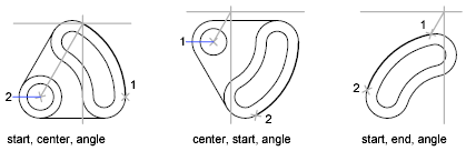

Draw Arcs by Specifying Start, Center, Angle
You can create an arc using a start point, center, and an included angle.
The distance between the start point and the center determines the radius. The other end of the arc is determined by specifying an included angle that uses the center of the arc as the vertex.
The included angle determines the endpoint of the arc. Use the Start, End, Angle method when you know both endpoints but cannot snap to a center point.
Click Home tab > Draw panel > Arc drop-down > Start, Center, Angle. Find
Click Home tab > Draw panel > Arc drop-down > Center, Start, Angle. Find
Click Home tab > Draw panel > Arc drop-down > Start, End, Angle. Find

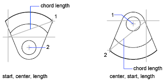

Draw Arcs by Specifying Start, Center, Length
You can create an arc using a start point, center, and the length of a chord.
The distance between the start point and the center determines the radius. The other end of the arc is determined by specifying the length of a chord between the start point and the endpoint of the arc.
The length of the chord of the arc determines the included angle.
Click Home tab > Draw panel > Arc drop-down > Start, Center, Length. Find
Click Home tab > Draw panel > Arc drop-down > Center, Start, Length. Find

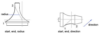

Draw Arcs by Specifying Start, End, Radius
You can create an arc using a start point, endpoint, and a radius.
The direction of the bulge of the arc is determined by the order in which you specify its endpoints. You can specify the radius either by entering it or by specifying a point at the desired radius distance.
Click Home tab > Draw panel > Arc drop-down > Start, End, Radius. Find
Click Home tab > Draw panel > Arc drop-down > Start, End, Direction. Find
