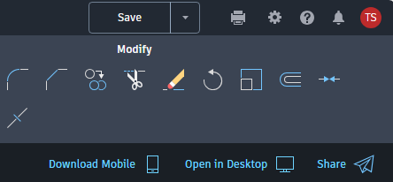

If you're working in the AutoCAD web app and your computer has AutoCAD 2018 or later installed, you can use the Open in Desktop button to open a drawing in desktop AutoCAD.
Your drawing is automatically saved and then opened in your locally installed version of AutoCAD or AutoCAD LT desktop.

- Click Open in Desktop. If the plugin is not yet installed, you will be prompted to download it.
