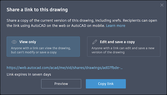

Share Drawing (Share URL)
Share a link to a copy of the current drawing to view or edit in AutoCAD on the web (web.autocad.com) or AutoCAD on mobile. All related DWG xrefs and images are included.
Find
For drawings that aren't saved to Autodesk Docs, share works similar to ETRANSMIT. The shared file includes all related dependent files such as xrefs and font files.
Anyone with the link can access the drawing in a web browser or in the mobile app. The link expires seven days after it's created. You can choose between two permission levels for recipients: View only and Edit and save a copy.
View only
Anyone with the link can view the drawing, including all xrefs. Recipients cannot make changes to the drawing, and cannot save or download a copy.
Anyone with the link can edit the drawing and save the drawing and all its xrefs as a copy. Recipients cannot make changes to the original drawing file that is owned by the sharer.
Note: When you save a drawing that has been shared with you, any xrefs will be saved to the same folder location as the parent file.
Can Edit (drawings saved in Autodesk Docs)
Drawing saved in Autodesk Docs include the option Can Edit instead of Edit and save a copy, which allows recipients to make changes directly to the drawing itself, instead of creating a new copy of the drawing.
