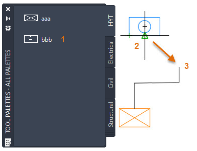

There are several tools and methods available for inserting blocks into a drawing. The one that you choose depends on how many different blocks you use and your workflow. If you haven't tried using tool palettes before, they might be the fastest method. See what you think.

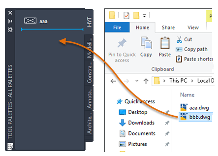

  7. Open the HYT Library folder in File Explorer. Then, drag the two drawing files onto the HYT palette.
    They are now available for inserting as block references.
    Note: For long block names, you can drag the edge of the palette to increase its width.

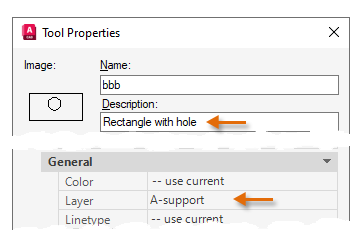

  9. Right-click each of the blocks that you added to the HYT palette and choose Properties from the menu.
    • Enter a description such as Rectangle with X for aaa and Rectangle with hole for bbb. The descriptions act as tooltips.
    • Set the default layer for aaa to A-support and for bbb to B-Support. This setting ensures that these block references appear on the specified layer regardless of the current layer.
    Note: If the layer that you specify isn't present in the current drawing, the layer will be created automatically when you insert one of the blocks.
    Notice the other options in the dialog box that provide settings for a scale, a fixed angle, an angle prompt, and so on.

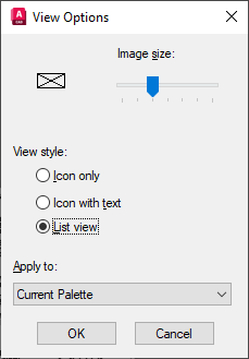

  10. Right-click in any unused area inside the HYT palette. Choose View Options from the menu.
  11. Experiment with the different settings and click OK to see the results.
  12. Drag several blocks from the palette into the drawing area.
  13. For better precision, click a block in the palette and use the Basepoint option to place the block references using different basepoints.
  14. Repeat the previous step for several additional block insertions.
