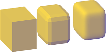

Modify Mesh Objects by Changing Properties
Mesh objects have additional properties that control the level of smoothness and creases. Crease properties of face, edge, and vertex subobjects are also reflected in the Properties palette.
  • Level of Smoothness. Smooths or sharpens the edges of a mesh object.
  • Crease Type. Specifies the presence of a crease (or sharpened edge) and the effect of smoothing. Smoothing does not affect a crease with a value of Always. A crease set to By Level retains its sharpness until the mesh object is smoothed to the specified crease level.
  • Crease Level. When a crease is set to By Level, indicates the smoothing level at which the crease starts to lose its sharpness.
