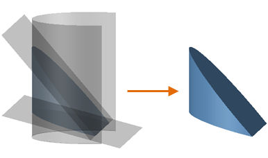

Use the SURFSCULPT command to convert a set of surfaces that completely enclose a volume to a 3D solid. In the illustration below, an extruded arc is intersected by two planar surfaces to enclose a "watertight" volume.
Note: A good practice is to make sure that the enclosing surfaces overlap or intersect to help you avoid tiny gaps.

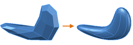

When you convert mesh objects to 3D solids, the shape of the new solid object approximates, but does not exactly duplicate, the original mesh object. You can control the differentiation somewhat by specifying whether the result is smooth or faceted with the SMOOTHMESHCONVERT system variable. You can also specify whether coplanar faces are merged, which optimizes them.
For example, the illustrated 3D mesh was first modified by increasing its smoothness level, and then it was converted into a smooth 3D solid.
