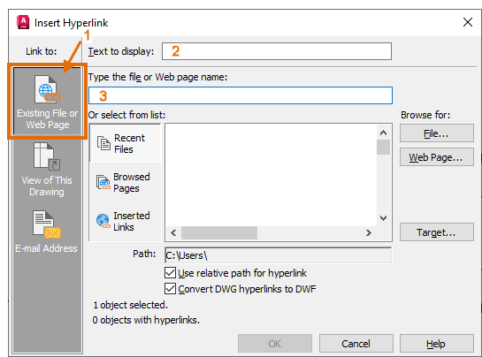

    The Insert Hyperlink dialog box displays.
    Note: You can select several objects to which to add or edit hyperlinks. Each object remains separate and a hyperlink is added to each one.
  4. In the Insert Hyperlink dialog box, click Existing File or Web Page (1), enter Autodesk in the Text to Display field (2), and enter https://www.autodesk.com in the Type the File or Web Page field (3).
    Note: If you want to see the hyperlink destination before opening or editing the hyperlink, leave the 'Text to Display' field blank.
  5. Click OK.

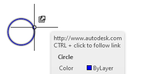

Now, when you hover over the circle, you see the hyperlink cursor and tooltip. Ctrl+click on the object to open the hyperlink.

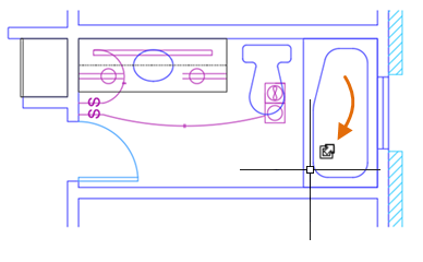

Select one or more objects in the block-whatever objects you want to respond to a cursor rollover-and use the HYPERLINK command. Then, every time you insert that block, the hyperlink is automatically included.
For example, when the block for this bathtub is inserted, the hyperlink cursor displays as shown below when you move the cursor over it.

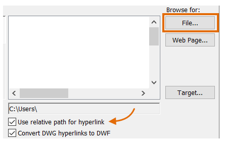

  3. In the Insert Hyperlink dialog box, click File. Then, browse to a file.
    Note: If you choose to use a relative path, the file will be more portable.
  4. Click OK and then test your hyperlink to the file.

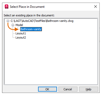

  3. In the Insert Hyperlink dialog box, click File and Browse to the file that you just saved.
  4. Then, click Target and expand the tree as shown:
  5. Click OK to close each dialog box.
  6. Move your cursor over the polyline and Ctrl+click.
    The drawing you specified opens to the view that you saved.
