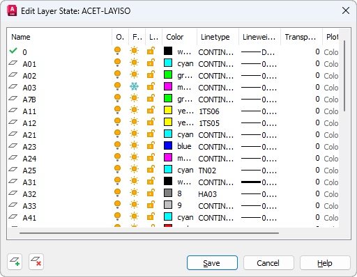

Edit Layer State Dialog Box
Modifies the selected layer state.
LAYER (Command) Find: Layer States Manager > Edit
Displays all the layers and their properties that are saved in the selected layer state.
List of Options
The following options are displayed.
Layer List
Displays a list of layers in the selected layer state and their properties.
Delete
Removes the selected layers from the layer state.
Add
Displays the Select Layers to Add to Layer States dialog box, in which you can add layers from the current drawing that are not defined in the layer state.
