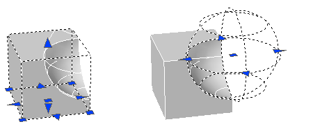

Modify Original Components of Composites
When the History property is set to Record (On), press the Ctrl key to display any original forms that were removed during a union, subtract, or intersect operation. If the original, removed form was a solid primitive, you can drag the displayed grips to change its shape and size. As a result, the composite object is modified.
If the selected individual form does not contain its history, you can move, rotate, scale, or delete the form.

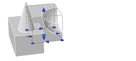

Modify Complex Composites
A composite object might be made up of other composite objects. You can select the history images of composite objects by holding down the Ctrl key as you click the forms. (For best results, set the subobject selection filter to Solid History.)
You can also change the size and shape of composite objects by clicking and dragging grips on individual faces, edges, and vertices.
