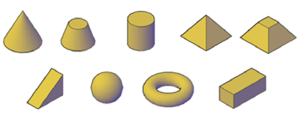

Specify 3D Solid Primitives
You can create several basic 3D shapes, known as solid primitives with commands such as CYLINDER, PYRAMID, and BOX.

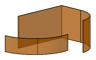

A fast way to create 3D solids in the shape of walls is with the POLYSOLID command. The process is similar to creating polyline including both straight and curved segments, except that you can specify a default height, width, and justification for the resulting 3D solid. You can also convert 2D objects such as a lines, polylines, arcs, and circles to 3D solids with this command.

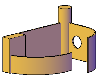

Create Composite 3D Solids With Boolean Operations
By combining 3D solids using Boolean operations such as union and subtract, you can create a single, composite solid as illustrated.
To create the hole, a cylinder was created and then subtracted from the wall.
