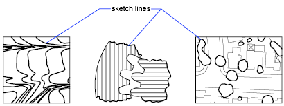

Sketching is useful for creating irregular boundaries or for tracing with a digitizer.
You can draw freehand sketches and then convert them into lines, polylines, or splines.
With the SKETCH command, you create a series of tiny segments. Setting the SKETCHINC system variable, you can control the incremental length of each segment. With the SKPOLY system variable, you can control whether the result is a series of independent line segments, a polyline, or a spline (the SKTOLERANCE system variable controls how closely the spline matches the original sketch).
