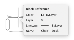

Rollover tooltips display current values of certain properties when the cursor hovers over an object in the drawing area.
The following properties are included:
  • Color
  • Layer
  • Linetype
  • Block Name

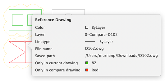

During a drawing compare, the rollover tooltip includes the following additional information:
  • Drawing name
  • Drawing path
  • Color for objects only in the current drawing
  • Color for objects in compared drawing
