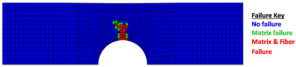

The image below shows a [0°/ ±45°]s unidirectional composite plate that was analyzed using the progressive failure feature. It shows a contour plot of the PFA Damage State variable, representing the composite damage state in the 0° plies. The blue areas represent composite material with unfailed constituents (PFA Damage State = 1), the green areas represent composite material with a failed matrix constituent (PFA Damage State = 2), and the red areas represent composite material with matrix and fiber constituents that have failed (PFA Damage State = 3).
failure key fix
Note: The number of possible discrete damage states for the composite material depends on the type of composite material (unidirectional or woven) and the specific set of material nonlinearity features that are used. For any given case, a description of each discrete composite damage state and its associated value is written in the summary file (*.mct) created during the preprocessing phase of the analysis. Additionally, you are referred to Appendix B which describes all of the discrete damage states that can be assumed by any composite material under any circumstances.
