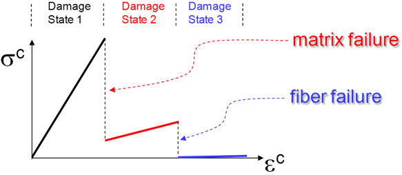

Instantaneous degradation is the default damage evolution method used by Helius PFA. When damage is predicted by the failure criterion and instantaneous degradation is used, the stiffness of the fiber and/or matrix is reduced to the minimum value instantly, as opposed to gradually. The magnitude of the reduction is controlled by the matrix and fiber degradation ratios (MPSTIF and FPSTIF). It should be noted that certain failure criterions, such as Max Stress, do not distinguish between the matrix and fiber. For these criterions, the stiffness of the composite is reduced instantly when failure is predicted, as opposed to independently reducing the matrix and fiber stiffnesses. To illustrate the effect of instant stiffness reduction, consider the graphic below which shows the stiffness of the composite at different damage states. The stiffness of the composite remains constant until matrix failure occurs, at which point the stiffness of the matrix is reduced to some ratio (MPSTIF) of the original stiffness. The reduction in matrix stiffness corresponds to a reduced composite stiffness and this reduction is applied in a single increment. When fiber failure occurs, the fiber stiffness is reduced according to FPSTIF and the composite stiffness is again reduced accordingly.

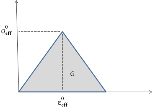

The definition of the final effective strain given in Eq. A7.4 assumes a linear degradation of the effective stress vs. effective strain relationship of the composite, as shown below.
ebd fix

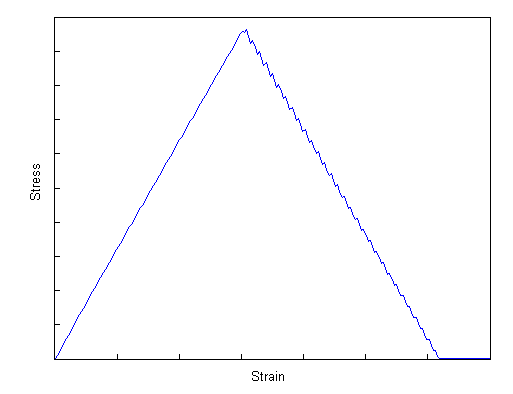

The Energy-Based damage feature of Helius PFA uses multiple discrete intervals when linearly degrading the composite, as shown below. Each interval uses a secant modulus to define the response of the composite in that specific interval. For problems where the total energy represents something similar to an isosceles triangle, the intervals will accurately capture the response of the composite.
linear partitioning

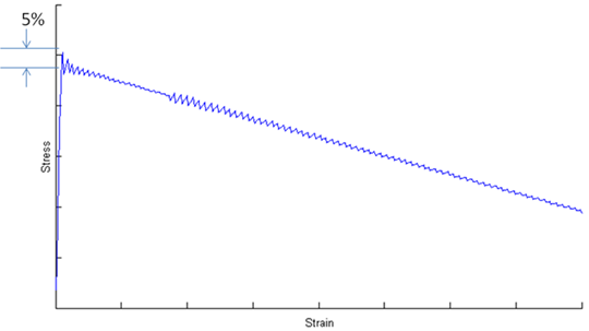

For analyses where the total energy represents a heavily skewed triangle, as shown below, interval partitioning will not accurately capture the linear softening of the composite at early strain levels. This is entirely due to the number of intervals used to achieve the most rapid and robust convergence of the problem. Specifically, the stress secant intervals at strain levels near failure retain a high stiffness and can cause a misrepresentation of the stress state of the composite. If you have analyses which must define a linear degradation curve in which the final effective strain is over 100 times the initial effective strain, please contact Autodesk for support.
modulus fix
