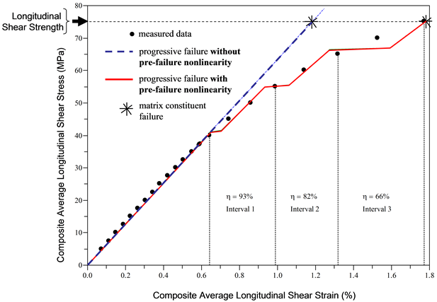

The pre-failure nonlinearity feature accounts for the nonlinear longitudinal shear (softening) response commonly observed in fiber-reinforced composite materials prior to ultimate failure. This additional form of nonlinearity involves imposing a series of discrete reductions in the longitudinal shear stiffness of the matrix constituent material (g12 supm and g13 supm) which directly results in a corresponding series of discrete reductions in the longitudinal shear stiffness of the composite material (g12 supc and g13 supc). Specifically, three discrete reductions are applied to unidirectional materials and six discrete reductions are applied to woven materials that use the reduced unit cell. Imposition of these discrete reductions in the longitudinal shear moduli are completed prior to matrix constituent failure, thus providing a longitudinal shear softening effect.
The plot below shows a typical measured longitudinal stress/strain curve for a unidirectional carbon/epoxy lamina. The pre-failure nonlinearity feature approximates this type of nonlinear longitudinal shear response with a four-segment, piecewise linear representation of the longitudinal shear response.
nl fix
We could create a similar plot for woven composite materials. In this case, rather than three discrete reductions in the longitudinal shear stiffness, we would see six discrete reductions that result in a seven-segment piecewise linear representation of the longitudinal shear response.
