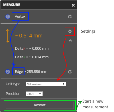

Measure
Select the Measure option. Click where you want to measure from. Click again at the point that you want to measure to. The measurement is displayed in the Measure pane.
In 2D designs, you can measure the following:
  • Edge to edge
  • Vertex to vertex
  • Edge to vertex and vice versa
  • Angle
3D measure is enabled for Fusion files. You can measure:
  • Arc
  • Area of a face
In addition, you can isolate the measured part. Click Settings within the Measure pane and select Isolate Measurement. The rest of the Design will be grayed out.
To change unit of measurement, click Settings in the Measure pane and select a unit of measurement from the Unit Type drop-down menu.
You can also set precision to 5 decimal places.
Zoom in if needed before you measure.
To measure a new part, click anywhere else within the viewer to release the previous selection or click Restart.
The following units of measurement are available:
  • Millimeters
  • Decimal Feet
  • Feet and fractional inches
  • Feet and decimal inches
  • Decimal inches
  • Fractional inches
  • Meters
  • Centimeters
  • Millimeters
  • Centimeters and millimeters
If your Fusion file is older than October 2015, updated it to the latest version to use the Measure feature.

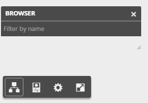

Model Browser
Select the model browser. Enter the name of the part that you want to look at in the Filter by name field.
Other parts of the model will be grayed out.
After you use the model browser to find a part, you can select sections of that part.
Click the Properties option to view the properties of your selection.
