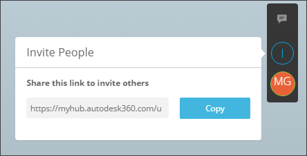

The Live Review feature provides a way to bring together Project Members and stakeholders to review a design or model. After you start a Live Review session, you can invite participants to a review session by sharing a link to the file. The person who starts the review session is the Host.
As participants join, you'll see them listed to the right. Anyone in the live review session can take control during the review by clicking anywhere on the screen. A red dot is displayed on the name of the person who has control.

To start a Live Review session
  1. Open the file you want to review in A360 viewer.
  2. Click Share on the top navigation bar > Live Review.
  3. Enter your name and click Start.
  4. Click Copy to copy the link to the file.
  5. Share the links with participants using a messaging services.
