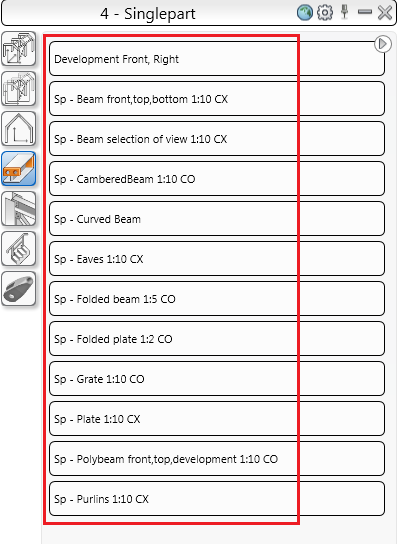

Customize the Set of Available Drawing Styles
Learn how to set the drawing styles that appear in the drawing styles palette.

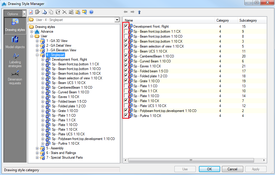

  1. In the Output tab Document Manager panel, click (Drawing style manager).
  2. In the Drawing Style Manager window select the category from which to add a drawing style.
  3. From the right side of the window enable the check box in front of the drawing styles you want to display in the Drawing Styles palette .
  4. Click OK.
  • Open the Drawing Styles palette to see the result.
