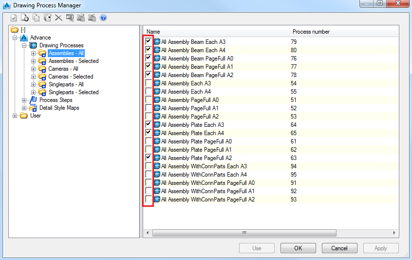

  1. In the Output tab Document Manager panel, click (Drawing process manager).
  2. In the Drawing Process Manager window select the category from which to add a drawing process.
  3. From the right side of the window enable the check box in front of the drawing processes you want to display in the Drawing Processes palette .
  4. Click OK.

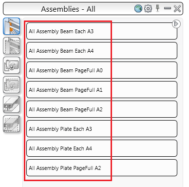

  • Open the Drawing Processes palette to see the result.
