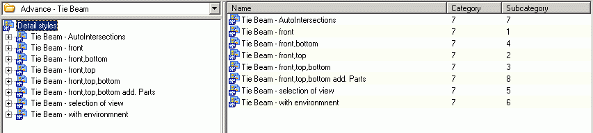

    The styles can also be manually called, using the _astm4CommDetailing User command and two numbers. The correspondence is available in the Drawing Style Manager window.
    The Name column displays the drawing style. The first number stands for the base category (e.g. column, tie beam), while the second one stands for the subcategory.
    Example: _astm4CommDetailing User 7 1 accesses the Tie Beam - front drawing style.
